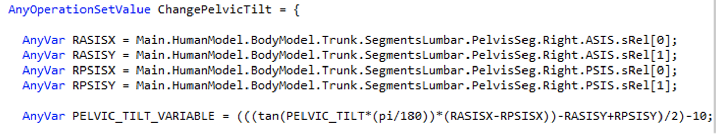

So my Macro for Pelvic Tilt looks like this:
This following errors occurs when I try to run it. It happens during the kinematic analysis.

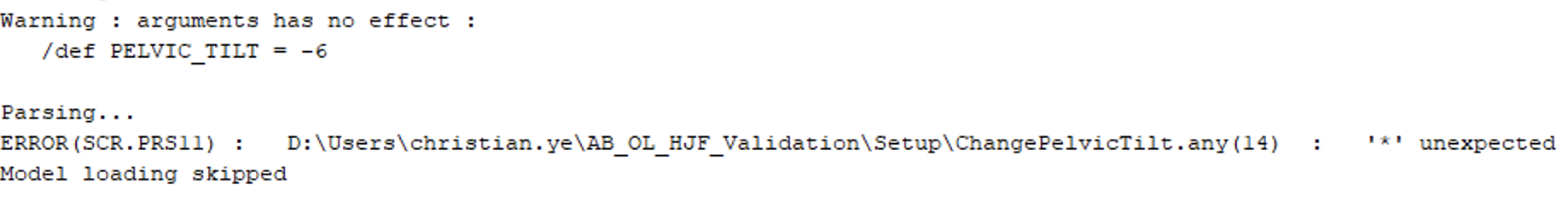

And this time with space in between just like in your post:
with the following macro:
/def PELVIC_TILT -6
I end up with a similar error like the first try when I put in the equal to sign. As you can see in the macro command: the other parameters work fine with the equal sign just as simulations with positive pelvic tilt variables. It somehow only appears when I use negative pelvic tilt variables. If I directly run the simulations in AnyBody I don't experience any errors with /def PELVIC_TILT -6. I'm not sure yet if this error is due to Matlab or AnyBody.
#### Macro command > load "Subjects\H1L\one_leg_stance\H1L_060511_1_24\H1L_060511_1_24.main.any" /def BM_LEG_MODEL=2 /def SUBJECT_SPECIFIC_ADAPTION=2 /def MARKER_SETUP=2 /def MUSCLE_RECRUITMENT=3 /def BM_LEG_MUSCLES_BOTH=1 /def BM_LEG_STRENGTH_INDEX=1 /def PELVIC_TILT -6
Loading Main : "D:\Users\christian.ye\AB_OL_HJF_Validation\Subjects\H1L\one_leg_stance\H1L_060511_1_24\H1L_060511_1_24.main.any"
Scanning...
Warning : arguments has no effect :
-6
Parsing...
ERROR(SCR.PRS11) : D:\Users\christian.ye\AB_OL_HJF_Validation\Setup\ChangePelvicTilt.any(11) : '*' unexpected
Model loading skipped
