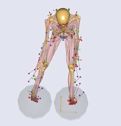

Like this,you can see the blue dot outside the model. In order to bring the red and blue dots closer,the red dots have to leave the model. Can this drive success?
Please take a look at this.This file has 60 frames in total.As shown in the picture,I adjust the red and blue dots very closely.But,I can only drive it to about 20 frames.The length of the body segment has been adjusted.Now,I don't know what the problem is?

Did you try to run the parameter study ?
In the ExtraDrivers.any file which joint drivers are enabled?
Which AMMR and AMS version are you using?

AMMR version 2.1.1,AMS version7.1. And whether running the parameter study is necessery? Looking forward to your reply.

AMS 7.2 have some improvements related to the kinematic solver as i recall it.
Try run the parameter study first it will optimize the dimensions to match markers.
Please also see this wiki post
