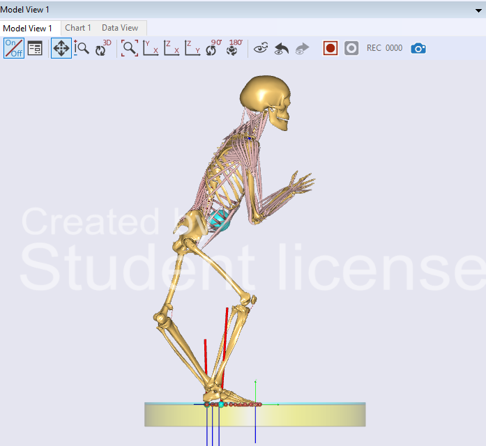

Hey everyone, I am currentl working on cutom scaling the femur of the Squat model from the AMMR. I already went through the AnyBody tutorial and so far everything worked out quite well. But no I want to include the Custom Scaling function and the mirrored one into the model and for some reason during the kinematic and inverse analysis the left knee bends in the wrong direction like this:

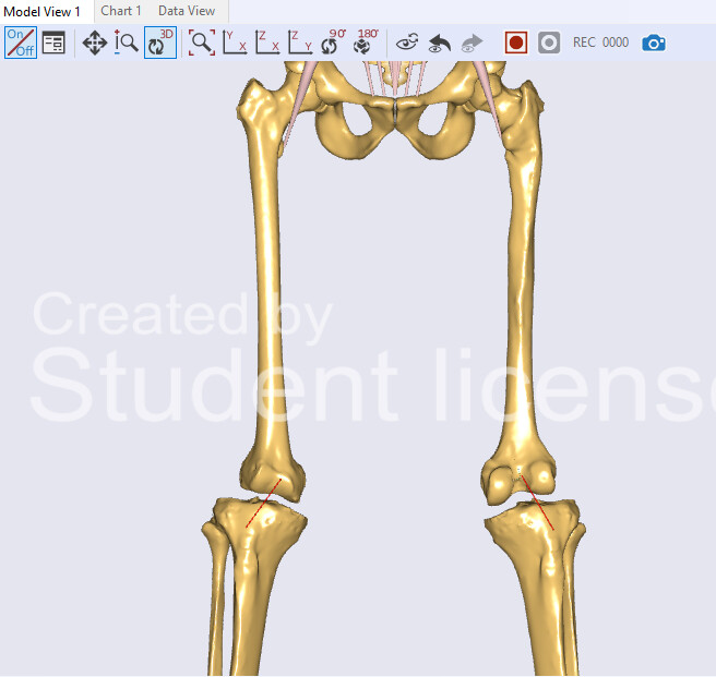

I found out i can fix this when I chang the ScaleMat of the Scaling function to ScaleMat = {{1,0,0},{0,1,0},{0,0,-1}}; but then the femur is in the wrong orientation like this:

I fixed the Problem. Apparently, since I use the AnyBody version 7.3 there were older tutorials listed under the help button, in which in the initial Scaling Function the TSeg2ScaleFrame was not used but it was used in the mirrored function. In the newer tutorials (from 2025) they fixed that.
