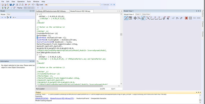

Hi Soren
I added the line of code to L2 and L3 vertebrae but it gives an error (ERROR(SCR.SCN6) : MarkerProtocol-RIZ-HW.any(275) : 'AnatomicalFrame' : Unexpected character.)
Screenshot attached.
Thanks and Best Regards
Abdul Aziz
Hi Abdul,
Sorry for not being more specific you need to add this lines in the L2 and L3 segments, not in the markerdriver.
if you add these lines e.g. in the top of the makerprotocol file.
Main.HumanModel.BodyModel.Trunk.SegmentsLumbar.L2Seg ={
AnyRefNode AnatomicalFrame ={};
 AnyRefNode& ScalingNode = AnatomicalFrame;
    AnyFunTransform3D& GeomScale = Scale;

Hi @parisa
It is a hard error to debug without the model, if it is possible could you send me a copy of the model for me to debug? please strip it of any sensitive information if you do so.
Did you get the inversion/eversion corrected?
You could try and explicitly rerun the parameter identification study if you have not done so after altering the model.
The errors you get seems to be regarding the glenohumeral joint and the buckle segment in the torso.
Maybe you can look at the inital position of you model and move it closer to the actual motion posture.
Also, after it fails try and use the "force recreate view" when right clicking the model view, this could show if any bodyparts are twisted in a wrong direction.
best regards,
AnyBody Technology
Dear Bjørn,
Thanks for your help. I reran parameter identification and also I moved the model closer to the actual motion posture, but it did not work. How can I send you a copy of the model? It seems that its size is big and it could not be attached.
Parisa
Hi Parisa,
I have looked at the model, here are my findings:
  • The posture is un-feasible, if you look at the ribs the clearly penetrate into pelvis.
  • The kinematic problem seems to originate from the abdominal pressure model, there are some measured in this model which will "flip" when the model has a posture like this. I have tried to make the model resilient to extreme posture like this but it did not solve your case.
    *First thing to try is to alter the pelvis markers so that you move markers on back down and markers on the front up this will force more pelvic tilt which would lead to less bending in the spine.
    Second thing you could try is to add joint limit drivers on the spine angles, there is a class for this in AMMR look in the folder, "Tools\ModelUtilities\KinematicLimits" you can use this class to add a limit on throraxpelvic flexion /lateral bend, this may force the posture to be more realistic and solve the kinematic problem.
Finally the model fails in first frame, it might be easier for the model to solve if you started the study in a less flexed position and then moved to this position.
Hope it helps.
