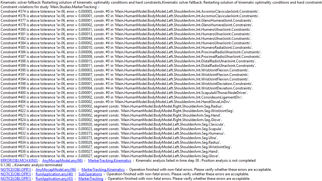

But for the majority of the patients, we have encountered problems starting from 'Marker Tracking' analysis.

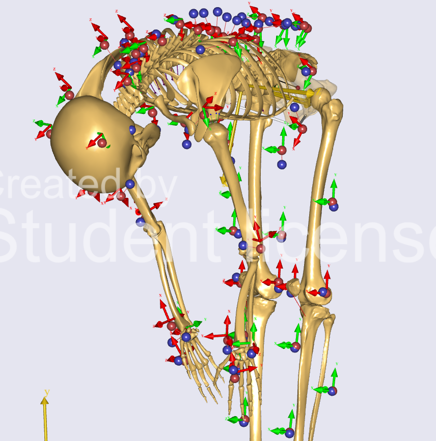

As you can see in the attachment, the simulation stops due to the fact that there are constraints over tolerance, especially the acromio clavicular joint, and this usually happens when the patient is in the maximum flexion position.

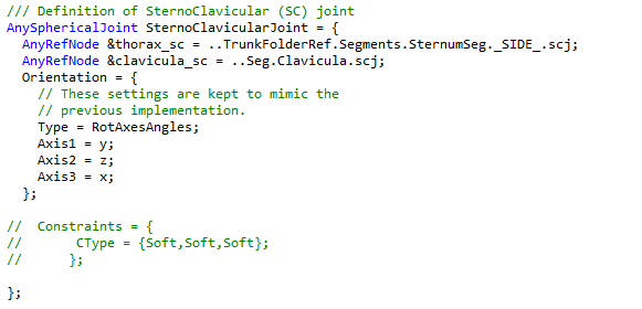

We've tried setting the spherical joint constraint to soft, which resolved the issue temporarily, but the same problem started re-appering in other joints.

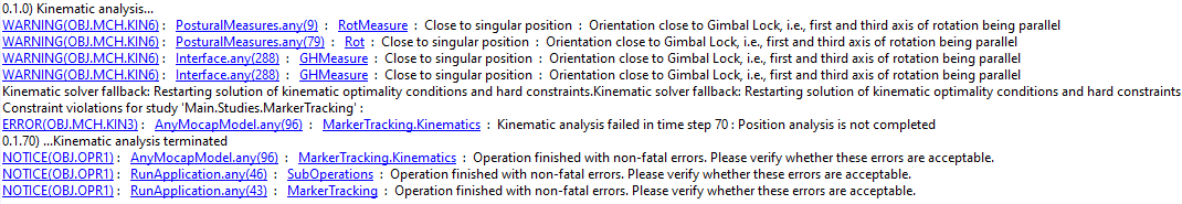

In other situations, before stopping the simulation, it gives out the following warning: 'Close to singular position: orientation close to Gimbal lock'.
We suppose all these errors are linked to the same original problem.

Hi Ginevra :slight_smile:
Make sure you are using the latest version of AMMR, as it could resolve some kinematic issues—especially if the problem lies in the abdominal layers. I’d recommend first running the model without the arms to identify where the issue originates.
If the problem is in the arms, it's likely related to the scapula-acromion-clavicle mechanism. This can often be improved with better scaling. Another approach you can try is adjusting the driver weights in the mentioned mechanism relative to the marker driver weights.
