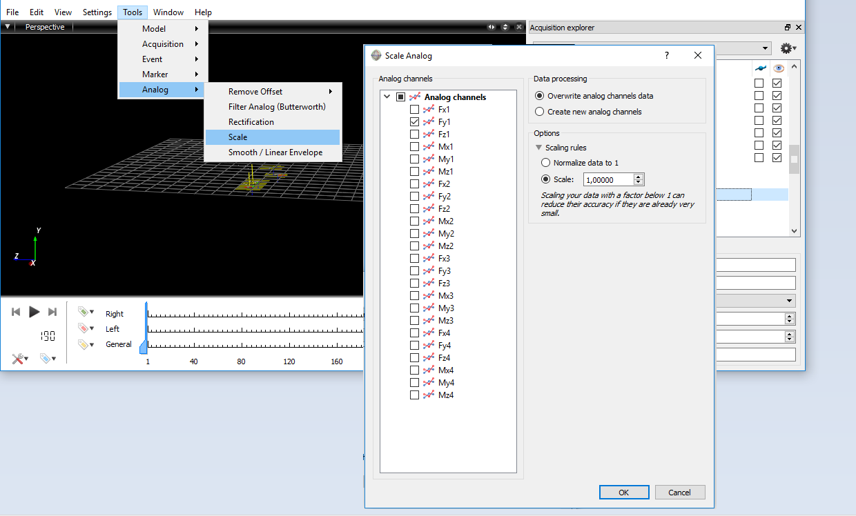

When I checked the c3d file from Visual3D, it is just okay but Mokka is not. The global reference frame of my gait model in Mokka is something weird. Compared to the force plate, the axis is totally different from the global reference frame. And also GRF has a problem. The direction of GRF is going down. In other words, it is opposite to the display of Visual3D even I use the same c3d. How can I fix it?
Thanks.
Donghwan Lee
