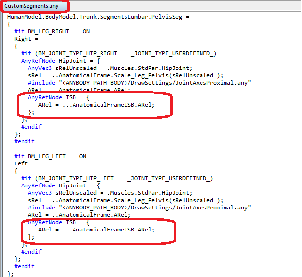

Hi,
You would need to add a couple of lines in CustomSegments.any (and maybe check that the code looks the same):
I believe this has been fixed, but not merged into the main branch just yet.
Kind regards,
Pavel
Hi Pavel,
thank you for your reply.
I’ve made the changes, but I’m now encountering another error:
WARNING(OBJ.MODELDEF1) :   ScalingCustom.any(69)  :   Patella.scaling_message_Right_Patella  :  Custom scaling for 'Right.Patella' segment is used! Please specify a scaling law should an 'Unresolved object' error occur
WARNING(OBJ.MODELDEF1) :   ScalingCustom.any(84)  :   Shank.scaling_message_Right_Shank  :  Custom scaling for 'Right.Shank' segment is used! Please specify a scaling law should an 'Unresolved object' error occur
WARNING(OBJ.MODELDEF1) :   ScalingCustom.any(99)  :   Thigh.scaling_message_Right_Thigh  :  Custom scaling for 'Right.Thigh' segment is used! Please specify a scaling law should an 'Unresolved object' error occur
WARNING(OBJ.MODELDEF1) :   ScalingCustom.any(247)  :   Patella.scaling_message_Left_Patella  :  Custom scaling for Left.Patella' segment is used! Please specify a scaling law should an 'Unresolved object' error occur
WARNING(OBJ.MODELDEF1) :   ScalingCustom.any(262)  :   Shank.scaling_message_Left_Shank  :  Custom scaling for 'Left.Shank' segment is used! Please specify a scaling law should an 'Unresolved object' error occur
WARNING(OBJ.MODELDEF1) :   ScalingCustom.any(276)  :   Thigh.scaling_message_Left_Thigh  :  Custom scaling for 'Left.Thigh' segment is used! Please specify a scaling law should an 'Unresolved object' error occur
ERROR(SCR.PRS9) :   CustomMuscles.any(11)  :   'MusPar'  :  Unresolved object
Could you please advise on how to resolve these warnings and the error?
Parisa
