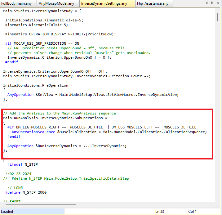

  1. As shown in the Inverse Dynamics settings of my model (Fig. 1), is the default muscle model in the AnyBody Modeling System used to predict metabolic power consumption? If not, which muscle model is recommended for this purpose, and how can I change it to a different model?

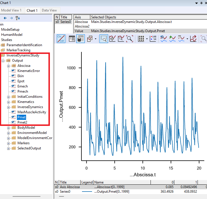

  1. Within the InverseDynamicStudy, the outputs include Pmet and Pmet2. Do these values represent the overall metabolic power consumption of the entire musculoskeletal model during the trial (as shown in Fig. 2)?

  1. The metabolic power can be computed for all types of muscles and their combinations. For example, it can be 3 element Hill muscles for the legs and simple muscles for the spine. Depending on the region of interest you can choose the muscle type.
  2. Pmet - yes. According to the ref. manual: "Pmet - The total metabolic power of all muscles in the study.". For Pmet2 is a bit different: "Alternative quantification of metabolic power useful for comparison. It comprises the metabolic power of the muscles specified in ‘MetabolicMuscles2’ using the metabolsim model specified in ‘MetabolicModel2’."
    So if you specified something in MetabolicMuscle2 - then it will not be the total power.

  1. As shown in the screenshot of my model settings, the "3-element Hill muscle model" has been implemented for both legs. I would like to confirm whether this is the recommended model for estimating metabolic power (Pmet), especially for lower extremity muscles, which are my primary areas of interest. I am interested in the lower body and a couple of back muscles.
I’m still exploring the muscle model settings to gain a deeper understanding. Could you please guide me on how to navigate through different muscle models in my simulation and how to modify or switch models if needed? I've come across different metabolic models such as: MetMdlUmberger2010, MetMdlBhargava2004, 3-element Hill muscle model, etc.
Which of these is typically set as the default or recommended model for accurate Pmet calculations? What are the steps to select or change the metabolic/muscle model if necessary?

The 3-element Hill muscle is supposed to be more accurate and provide more detailed output. As far as I remember this is our default choice for the body parts where detailed information was available for this muscle model type. Whereas different metabolic models have their own pros and cons and underlying assumptions. That said the class-demo example I suggested in my previous post shows how you can use several of them at the same time for comparison:
