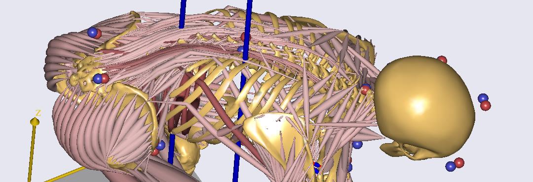

Hi Bjorn,
1-By looking at the model view, I noticed that some muscles are locating wrong and they penetrate other surfaces. For example, please look at the picture below. It seems that the muscle Latissimus Dorsi4 has a problem, but I do not know how to fix it. Also, I do not know how to find other muscles which have a similar problem. I noticed it just by looking at the model view. Please let me know how to solve the wrapping problem.
2-As you asked, I omitted the code lines about forces in hands, and I ran the inverse dynamic. The warnings about muscle overload disappeared(the magnitude of the load is about 11 kg). However, it is obvious that the output of the model for compression force on the spine was not reasonable, since the force plate includes external force in hand plus the body weight. It seems that in this case, the magnitude of the load creates the problem in overload muscles. On the other hand, it is necessary to have this load in hand and see its effects on compression forces on the spine with this posture. I would be thankful if you give me your advice.
Bests,
Parisa
Hi @parisa
The latissimus wrapping you are seeing is not wrong. It is simply the wrapping surface combined with the posture that makes I look like it is wrapping
under that rib.
Do you have the possibility to share that model that includes the force added to the hands, we would like to debug it further.
The posture is really pushing the limits of that the model can do so we would like to see if we can improve its stability here.
AnyBody Technology
