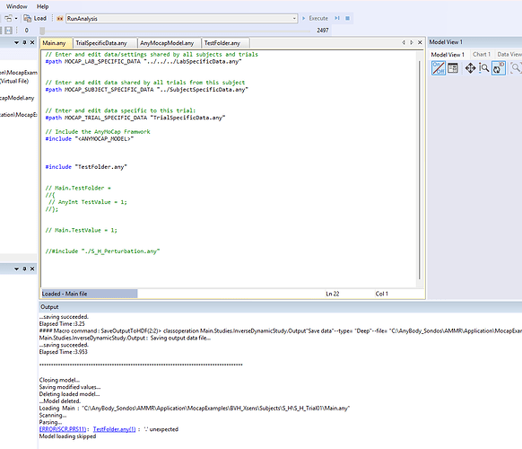

As soon as I try to add any new AnyScript code, the model fails during parsing.

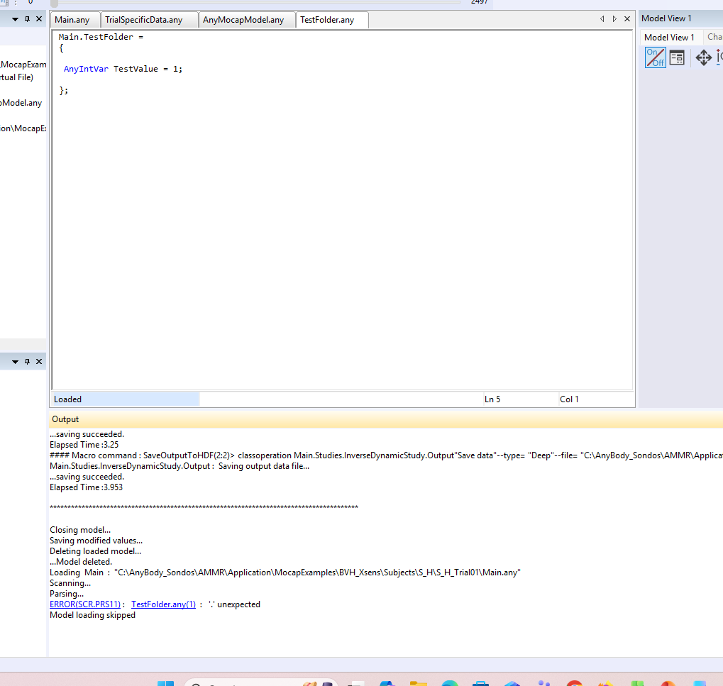

For example, I created a new file called TestFolder.any in the same directory as Main.any and added the following minimal content:
Main.TestFolder =
AnyIntVar TestValue = 1;
Then I added this line to Main.any (after the AnyMoCap model include):
#include "TestFolder.any"

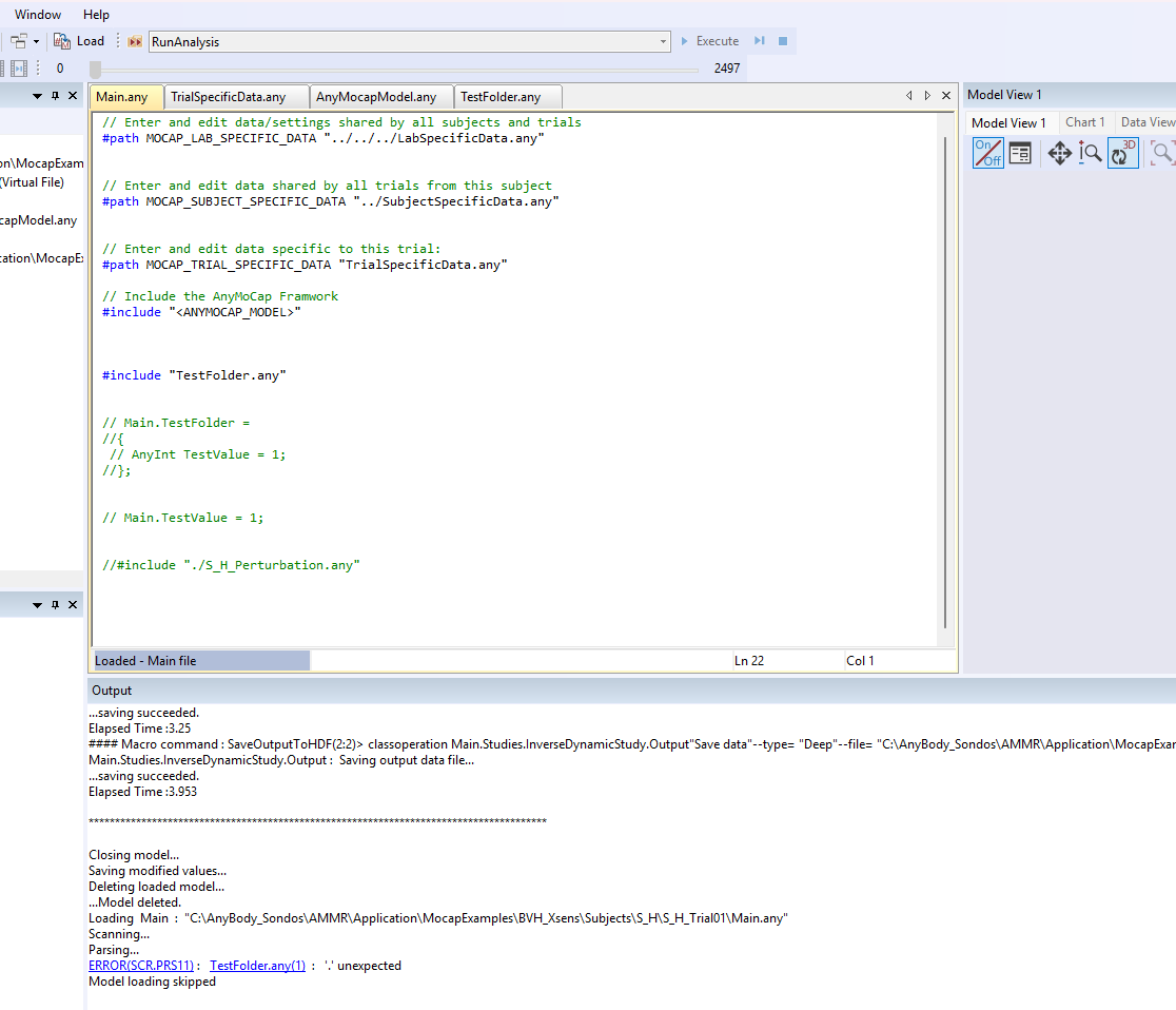

This immediately causes parsing errors when loading the model.
Typical errors I see:
  • ERROR(SCR.PRS11): '{' unexpected
  • ERROR(SCR.PRS11): '.' unexpected
  • ERROR(SCR.PRS12): 'AnyFolder' when 'Main' was expected
These errors occur before any analysis runs.
Observations:
  • The model works as long as I only edit existing files pulled in via #path (SubjectSpecificData.any, TrialSpecificData.any).
  • Any attempt to include a new .any file causes parsing errors, even with very simple content.
  • I have tried different file names, moving the include line, and simplifying the code further, but the result is always the same.
  • This makes me suspect there are specific constraints on how the BVH_Xsens / AnyMoCap example is intended to be extended.

Hello Sondos,
Welcome to the AnyScript Forum! Firstly, can I please ask you to update your affiliation in the user profile to write your organization name?
I am not sure why you are seeing the AMMR files as read only. Are you working in the installation directory? Have you copied the files yourself from the installation directory? The AMMR files in the installation directory are marked as read-only to prevent accidental changes. Please see this page and its subpages to understand how to work with AMMR.
Regarding the error you are seeing, please update the code to
Main = {
  AnyFolder TestFolder = {
You are outside the scope of Main at the place where you typed your code. Therefore, you must open the scope of Main, and then inside Main, you can use the full statements like Main.TestFolder. Also, you have to define TestFolder somewhere in your model using the AnyFolder class. Main.TestFolder looks for an object called TestFolder, and you will get an unresolved object error, if you haven't defined it correctly.
