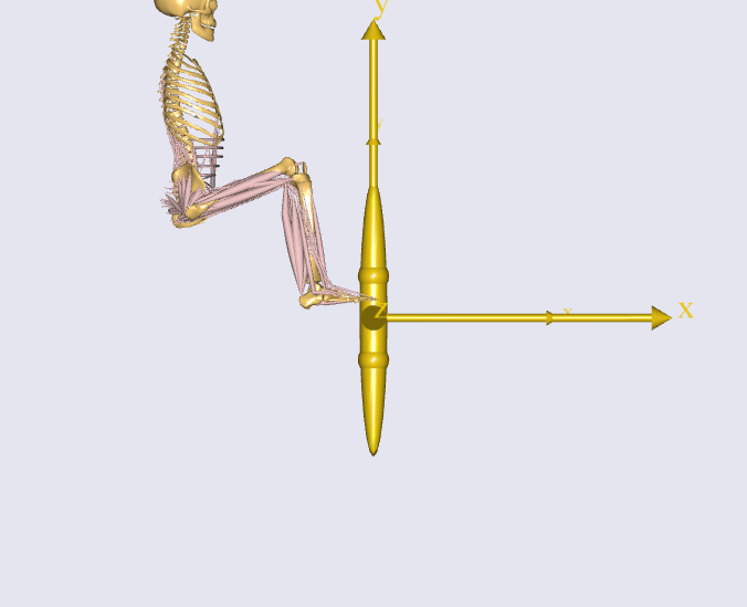

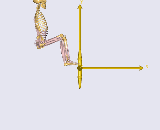

Hi,AnyBody,
When I change the mass of a Seg, its size will change. Is this normal?
The mass of pedal in the following two figures is 1 and 2 respectively.It can be seen that the pedals in the two figures are different in size。

Hi @Chen1227
The drawing represents the inertia of the segment which is why it varies with the mass.
It will shrink when you increase the mass and grow when you decrease the mass.
