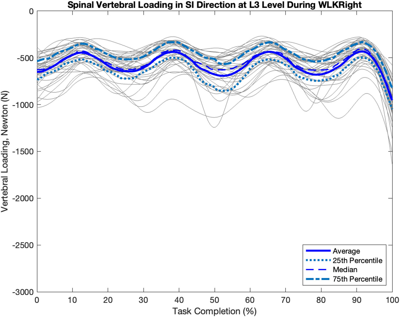

Almost all simulations were successful. However, the loading in the vertebral spine (in all levels) seems to be taking off at the end of the C3D file for ALL of the simulations (see photo below) instead of just continue the cyclic loading since the participants were still walking afterwards!
The graphs shows axial loading at L3 level during 2 gait cycles (first 50% task completion is first gait cycle and the last 50% task completion is the second gait cycle) for about 40 odd people. The same phenomenon happened in all other vertebral levels too
So, I am just wondering if there is some sort of setting that I may have missed that could cause/prevent this? An additional context: my FirstFrame and LastFrame settings for the C3D files has +/-5 frames as buffer.

Generally speaking, the loads are reflection of kinematics of the body. Sharp accelerations / decelerations could lead to increase / drop in forces. You seem to have an increase in the compressive forces - try checking if you see accelerations. You can try plotting CoM/Sternum/Pelvis accelerations against these curves.
The second theory is that interpolation functions /filters unnaturally reduce ground reaction forces or affect kinematics. Or when the subjects were leaving force plates we are lacking some input. You say you take the motion in the middle - would it be possible to analyze more frames around the RoI, but still look within the region. To exclude bad filters / interpolation.
Please check these theories?
