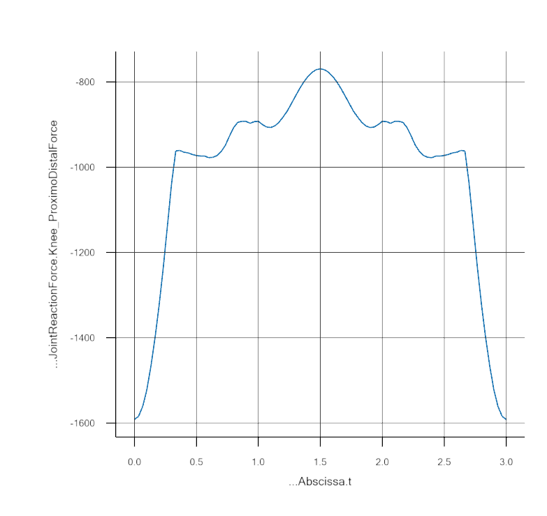

I have a question about the JointReactionForces of the Knee in the generic Squat model. I am working on a Project where i need those Forces but i checked the Knee_ProximoDistalForce and I am confused as to why the Force becomes zero at the lowest Point of the squat. I also tried to plot the absolute value of the Force and the graph seems more plausible now but its still zero in the middle. Can anyone explain as to why this is? I compared the data with the THA-KneeBendDemo from the AMMR and the graph is completely different and also never reaches zero.

I am not able to reproduce this error. Here is the graph that I see for the generic squat model:
Can you please try to check again with a clean installation of the AMMR?
