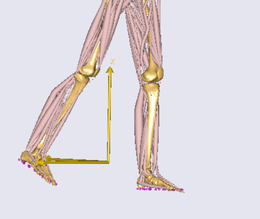

April'7 Hey, I want to get a GRF prediction , but the orientation(blue line) is like this ,i don't know how to change this to get the correct orientation. AnyBody 6.0 (64-bit)
Thank you for help!

It may look like the person is "hanging upside down in his feet's, this would explain the direction of the vectors to me.
I would try to flip the person around so he would be standing the other way upside down, this might solve the problem.

I think you are right it is not super easy to change the direction of how the motion was recorded in this model.
I suggest instead:
  • Change direction of gravity
  • Flip the frame which is used for the GRF prediction basis so that it points upwards look in the Forceplate_GRFPrediction.any file and change the PLATE_BASE_FRAME to a frame which is pointing upwards.
  • You can simply create a new frame for this using an AnyFixedRefFrame with altered Axes value e.g. Axes= RotMat(0.5*pi, x) (not sure on if it should be x since i can not see it on picture.)

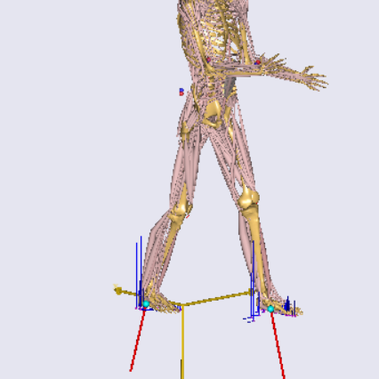

I follow your advices,and I change the direction of gravity,also flip the AnyFixedRefFrame to make it point upside,such as the following picture,but I don't know how to change the PLATE_BASE_FRAME,please give me some detalis,thang you very much !
Best wishes!

If you have changed the direction of the GlobalRefFrame you are fine, this is the one which is used by the GRF prediction, then you do not need a new frame.
From the picture it looks like the frame is a bit high with respect to the ground this may impact the way the predictions are done so it might be a good idea to raise it a bit in the z direction to make it on line with feet surface. To do that change the "Origin" value of the frame.
So you do not need to change the PLATE_BASE_FRAME since you simply modified the frame it was already pointing at which i think is fine.
Concerning the question how to change it, this would is done in the "Forceplate_GRFPrediction.any " file
By changing the line " PLATE_BASE_FRAME = Main.EnvironmentModel.GlobalRef" to be pointing at something else.

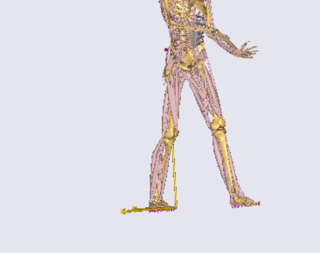

Thank you for the details! I run the Inverse dynamic analysis,but I can't find the GRF prediction(blue line ),it is just like nothing.AnyBody 6.0 .3

Please upload the model so i can see exactly what you have done, at this point i am unsure why it seems not to work.
Please ensure that you do run the inverse study, if you ran a kinematic study it could explain it.
