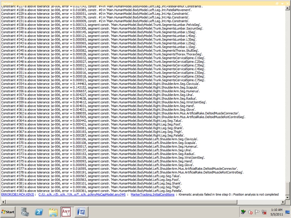

A subject was made to perform abduction and adduction and it was captured using Xsens. Then the bvh file was imported into Mocap examples. But during kinematic analysis error keeps generating stating that position analysis is not completed.
What is supposed to be done to eliminate the error? Requesting your suggestions.

It is pretty hard to say exactly what the error is.
Try and make sure that it is not loading .anyset data that are not correct or from another trial.
Does the marker tracking study work? how does the error look?
Do your .bvh file contain a t-pose in the first frame? if so make sure to remove it or start the simulation a few frames after.
